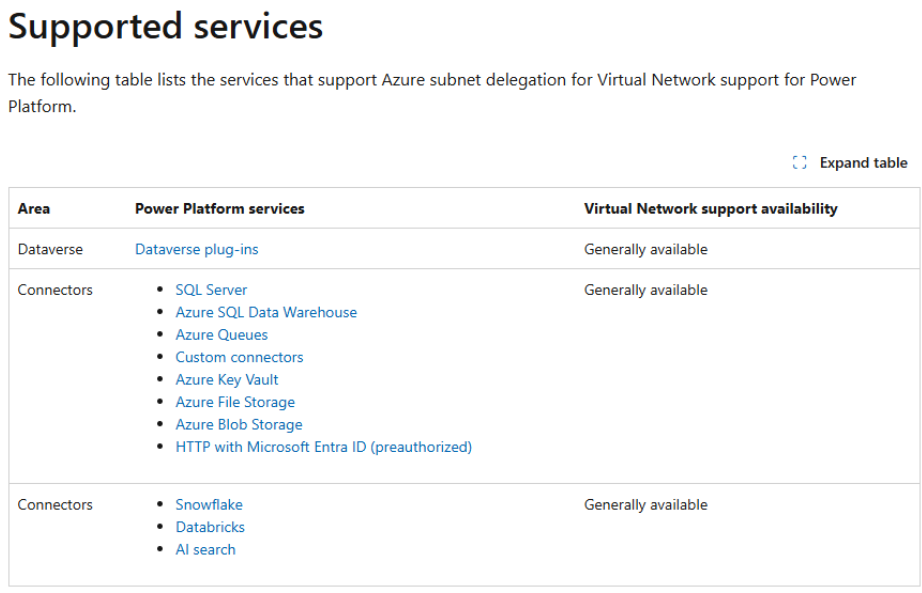

I’m currently troubleshooting an issue where Power Automate (Power Platform) with Virtual Network integration is unable to connect to Azure Table Storage.
While reviewing the Microsoft documentation for Virtual Network support in Power Platform, I noticed that Azure Table Storage isn’t listed among the supported connectors.
User's image

Based on this information, it appears that Azure Table Storage may not currently be supported when using Power Platform VNet integration.

    Yes, you are right, it is not listed! Azure Table Storage is not supported for Power Platform VNet Integration.
    It is missing from the official list of VNet‑supported connectors and services, so Power Automate cannot reach it when an environment uses delegated subnet integration. The correct workaround is to introduce a VNet‑integrated API layer (Azure Functions or API Management) and consume Table Storage through that secured endpoint.
    By placing a "proxy" layer that does support VNet integration between Power Automate and Table Storage, you bridge the gap.
