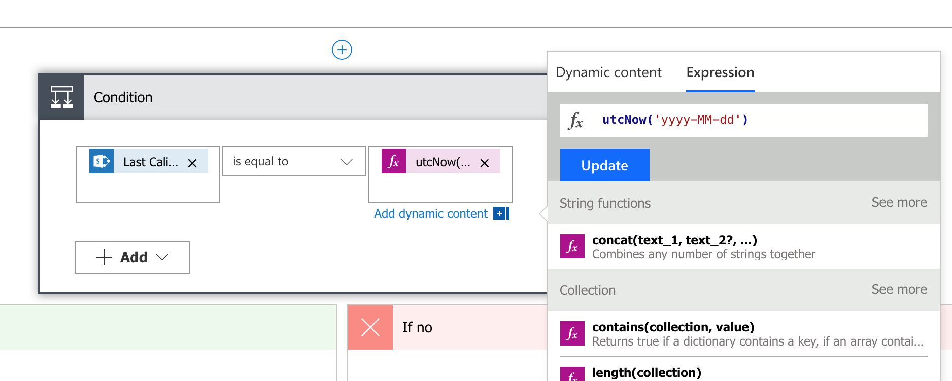

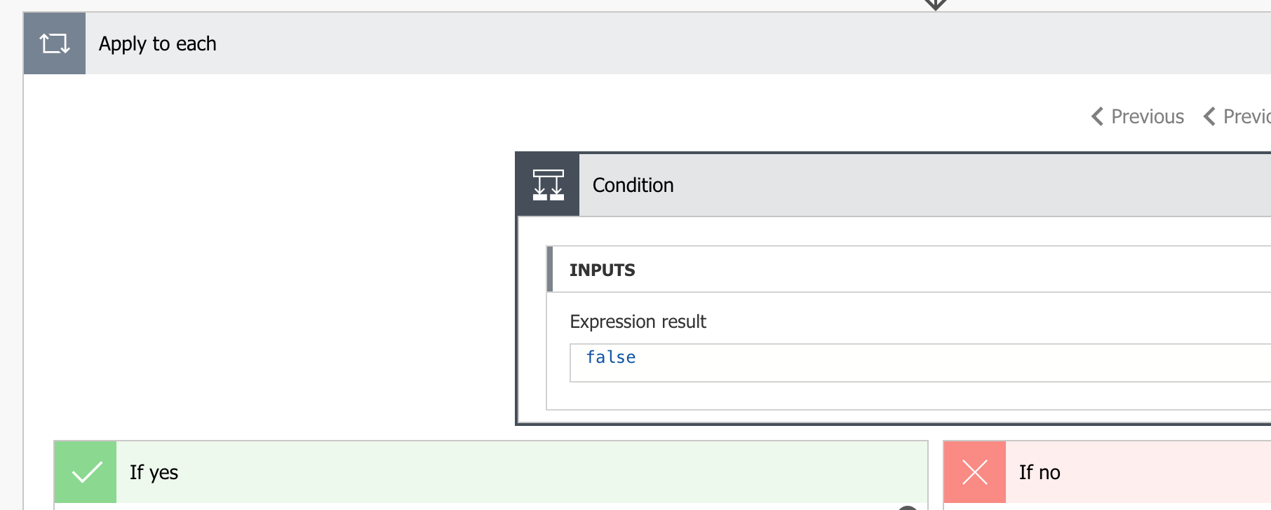

I'm trying to set up a fairly simple flow. Check date of SharePoint column (Calculated column formatted as date) equal to utcNow(yyyy-MM-dd). It wont work. I've created an entry in the SharePoint list with the date of today, and it still shows condition as false.
Even trying on a non calculated column its not working. Yet I have another list/flow and it works fine.
 And yet it is quite clearly 01/03/2019.

    Hi @aobr31569 , I will try to assist.
    what's the actual WDL for:Capture-301.png
    As I would try
    equals(<Last Cali...>, utcNow(yyyy-MM-dd))
    then make that equal to true(expression).
    That may work or post the output of the SharePoint connector JSON that has generated <Last Cali...> and I will do my best to assist.
