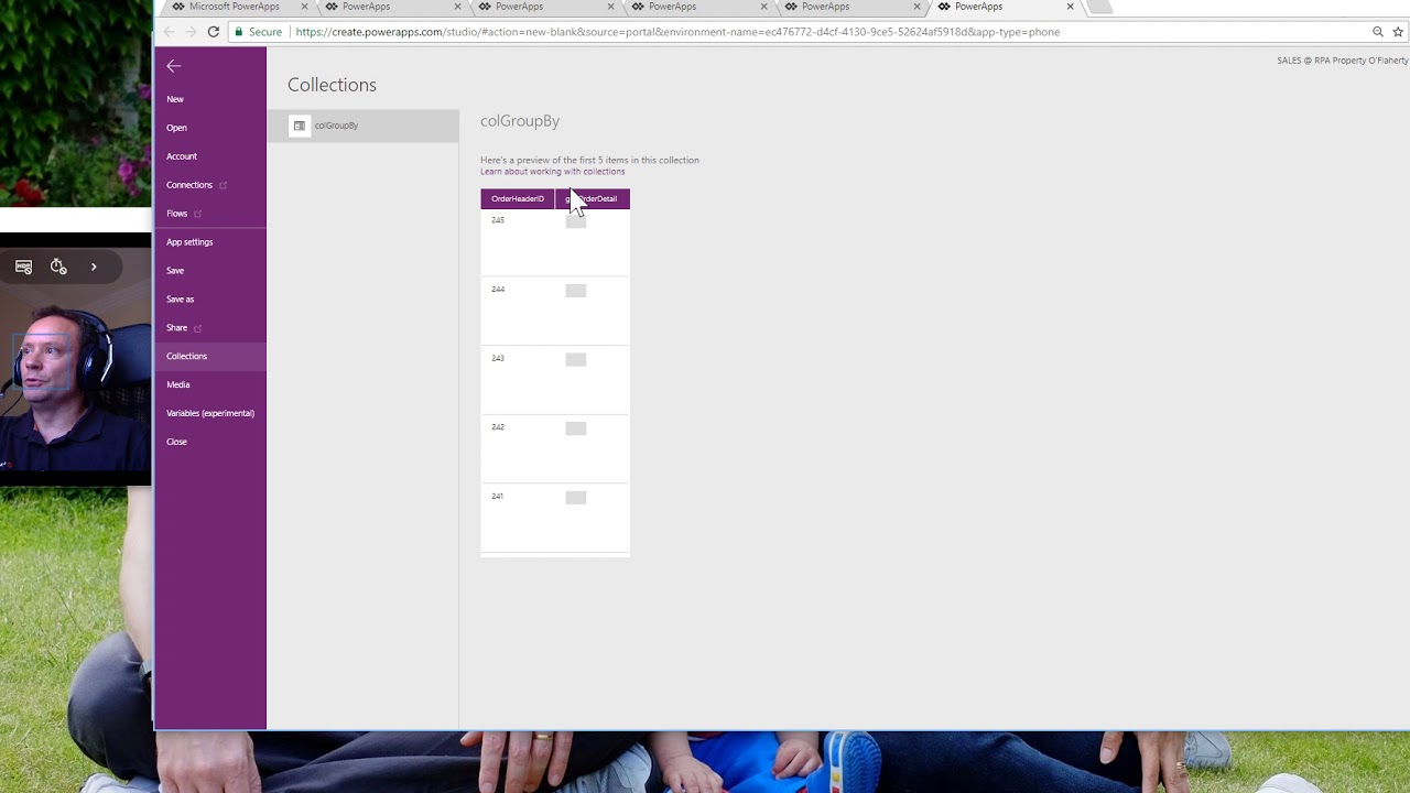

PowerApps: Gallery / SubGallery using GroupBy and Flexible Height
Nesting a gallery with another gallery to show related data - e.g. an Order Header with multiple rows of Order Details beneath.
A key concept is the use of the GroupBy function to 'shape' your data and controlling the height of flexible height galleries so your detail rows are always visible.
