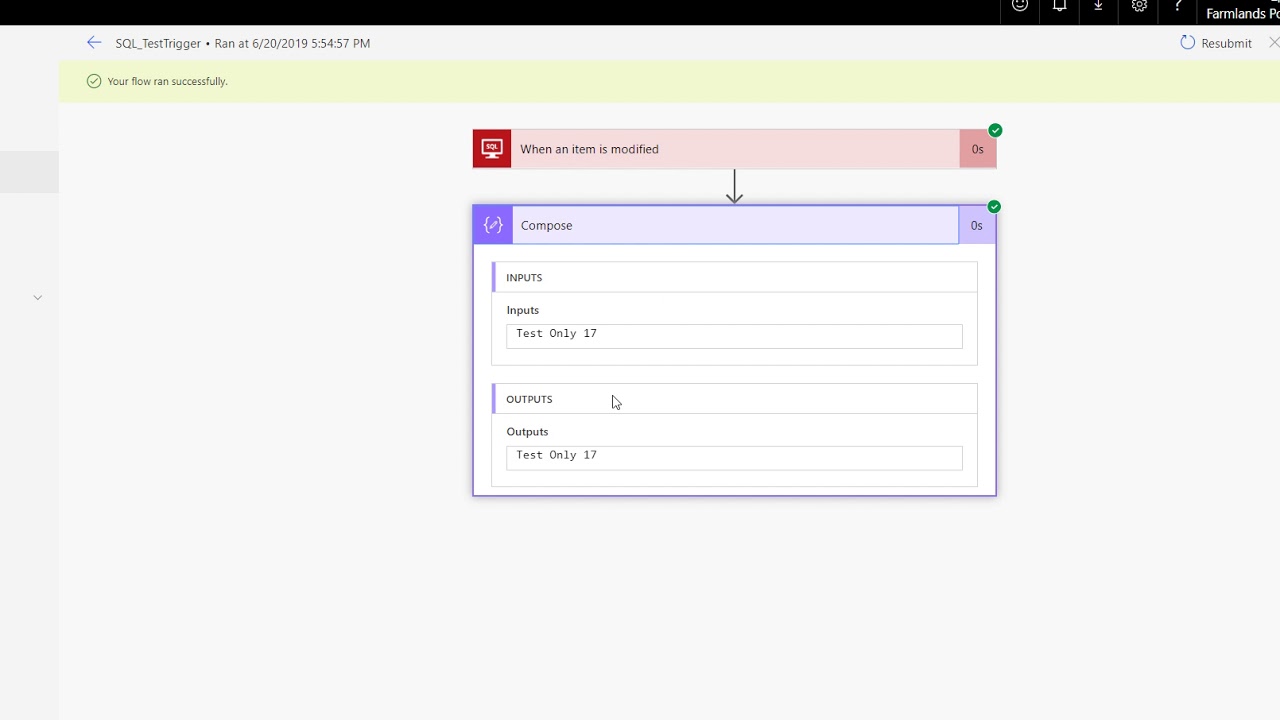

Using the 'When an Item is modified' trigger with Azure SQL DB
I've recenly been working with Flow's 'When an Item is modified' trigger for Azure SQL DB, and thought I'd share some learnings.
Pre-requisites, how it works, peformance suggestions and some considerations and pitfalls to avoid.

    Hi PaulD1,
    THANKS for the explanation!!
    The RowVersion in the SQL table was my problem that this trigger was NOT working.
    dchan1
    How do you get the data from only those columns that have been modified? It seem to return to whole row.
  • LencoTB Profile Picture LencoTB
    Great video. Just a question. I am using Azure SQL and I can't see Indexes folder just as you can in the video. When checking for the Top Queries I see that the it uses Clustered Index Scan on the whole row. I am not sure if this is okay or how to create an index just for the RowVersion column
