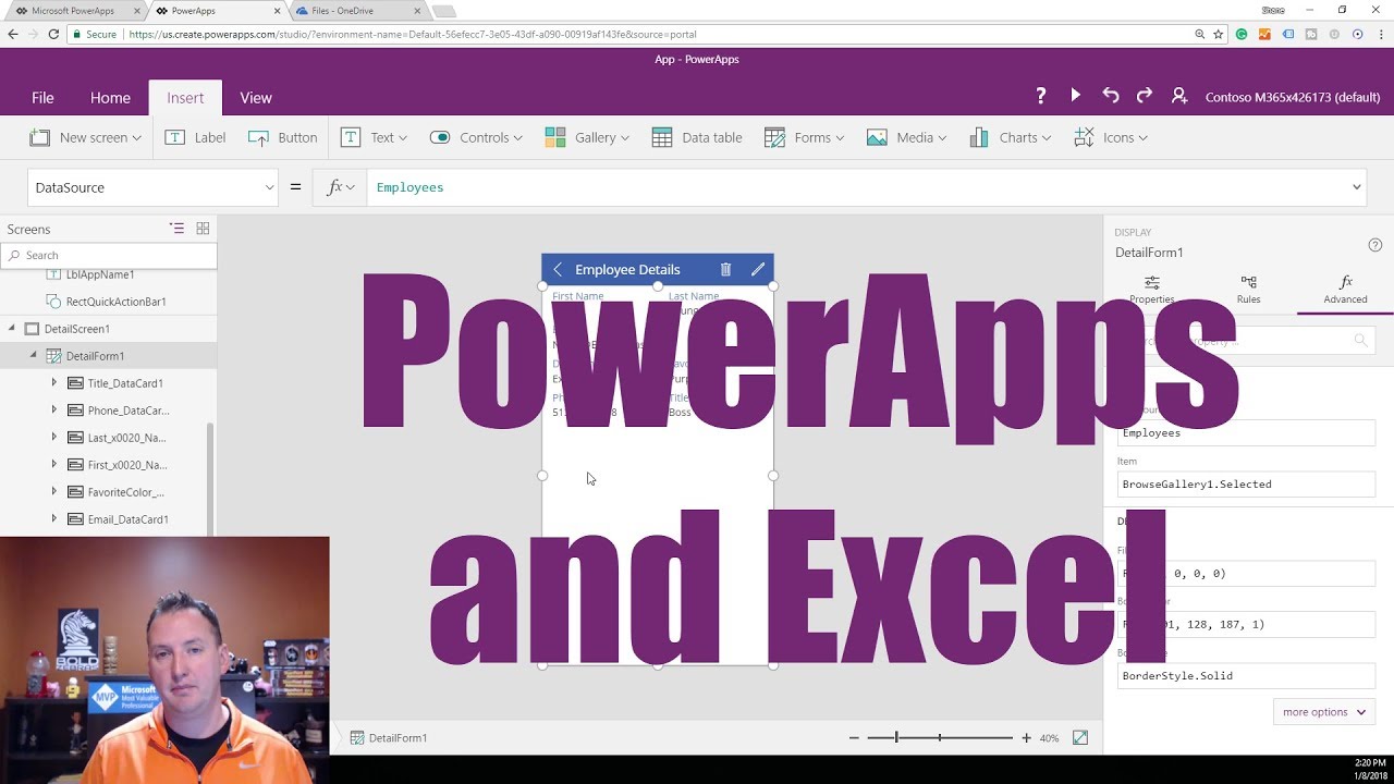

Get Started with PowerApps and Excel
In this video, we do a walkthrough of creating your first PowerApps App using an Excel workbook hosted on OneDrive for Business as the data source. Then we make a couple of quick tweaks just to make it a little nicer. This is a foundational video that will allow us to cover more complicated topics in future videos.
