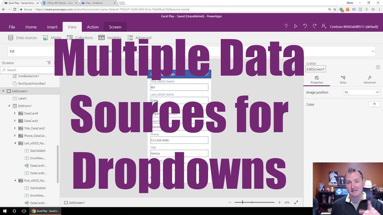

In this video, you are going to learn about PowerApps Multiple Data Sources. You will connect your app to SharePoint and Excel data sources using OneDrive.
