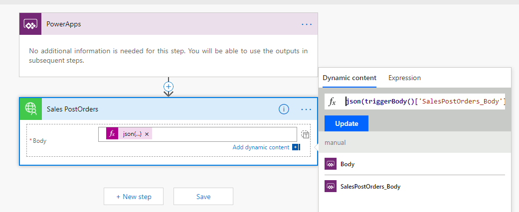

I have the following flow that sends a json body to a Custom PowerApps connector to a custom API. When testing the flow it completes successfully. The same when I test the custom connector directly.
Flow
But when I try to add it to a button I have the following error:
enter image description here
Attached you will find the OpenAPI file used for the custom connector.

    Please check if the result the json function returned has a proper JSON schema. In other words, please check if there are some columns which did not have its type defined within the JSON schema.

    The official Microsoft Response was that I should not use string as input to the custom connector but instead use Compose - Parse json and this solution resolved my problem. Attached the image.
