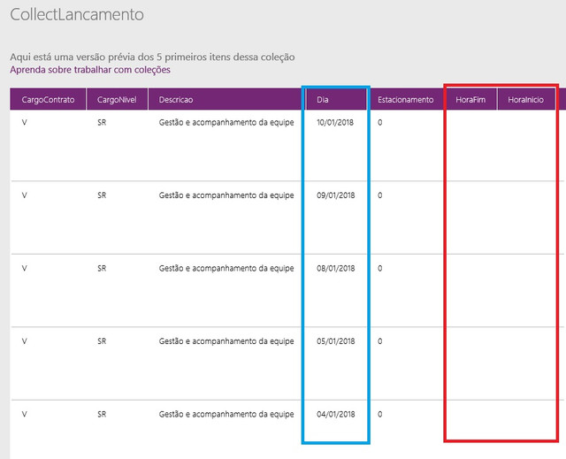

My app is not showing datetime2 values from my table. It stopped working without any change in the app or the table.
It doesn't show up in my collections either while date only columns are working properly. The image bellow shows one collection where the date data type (blue) works and the datetime2 (red) doesn't.
I couldn't find any information about current issues with Azure SQL or Powerapps. Any help is appreciated.
powerapps datetime2

    Thanks for the link @Meneghino. I'm aware that there are issues with all kind of datetime data types and SQL Connections. I had to do myself many workarounds to make my app work properly.
    The thing is that something has changed. Because the issue started without any changes on my side. My code was working fine two days ago.
    I can confirm what @wyotim said. There is something wrong with the sort operator. When I remove the sort it works fine.
    My code bellow where HoraInicio is a datetime2 data type.
    ClearCollect(CollectLancamento;
     SortByColumns(
     Filter('[dbo].[Horas]';
     dias_lancamento <= DataCorte;
     ID_user = Usuario
     "HoraInicio"; Ascending
