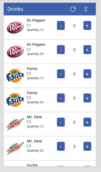

I'm trying to have an app that just takes a gallary and lets a user change a simple value as a scratch paper. I have a label inside a the gallery and using 2 buttons to add or subtract 1 from the label.
I'm using Set(LabelVariable, LabelVariable + 1) for the button function and nothing changes... what am i doing wrong?

  • v-yamao-msft Profile Picture
    on 21 Sep 2017 at 08:43:04
    Re: Change Value within one row ONLY in Gallery
    Hi AlexNW,
    After you configure the set function on a Button’s OnSelect property, you also need to set the Label’s Text property with LabelVariable.
    Then when you click the button, the number in the Label will be changed.
    However, I am afraid it won’t work for your scenario.
    No matter which data source you are using, please add a column for LabelVariable in the data source.
    On the app, you will need to add another screen.
    On the new screen, add a label and set its Text property as Gallery1.Selected.name.
    Then add two buttons, use the function Set(LabelVariable, LabelVariable + 1), add another label and set its Text property as LabelVariable.
    Besides, you will need a Save button to save the data to data source with the changes you have made. You may consider to use Patch function in this case.
    After you patched the changes to data source, refresh the gallery, it will be displayed on the Gallery screen for selected item.
    Please try it on your side and feel free reply if you need more help.
